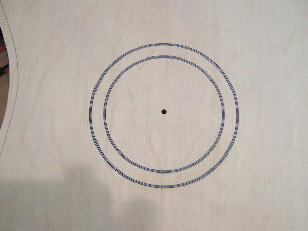

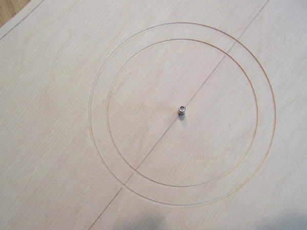

First, I routed two grooves for some purfling boundaries.
Then I installed the rings:

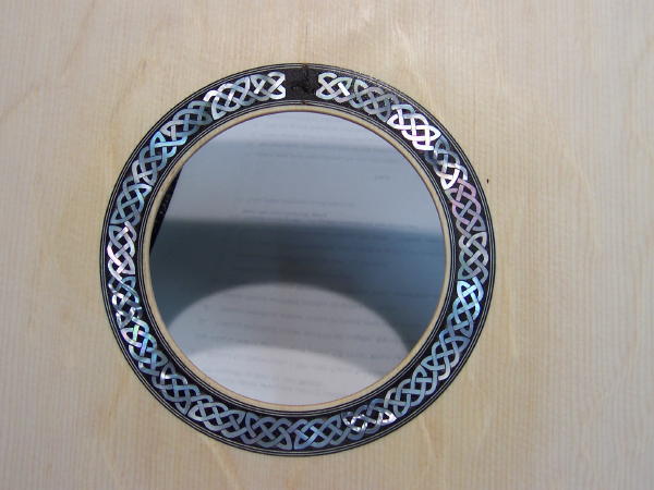

Next, I routed out all the area between the rings (I really, really can recommend the new StewMac circle attachment with the micro adjustment). Then installed the Celtic ring:

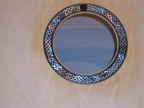

Here is another shot with the light from a different angle.
The rosette comes from Andy glued onto a piece of cardboard. I used clear duct tape and pressed it very tightly onto the top of the pearl then soaked the whole thing in hot water about 5 minutes. That released the rosette from the cardboard and the tape kept it all together. I turned it over and cleaned the glue residue from the bottom side of the MOP and trimmed the tape close to the rosette. Filled my groove with epoxy colored with ebony dust, flipped the rosette over and placed it in the groove intact. Clamped it down overnight and started cleaning it up today. Still a little cleaning to do, but I'm pleased. I was really worried the thing would come apart and I'd have to reassemble it. I had to sand it down and fill pinholes three times to get them all.
